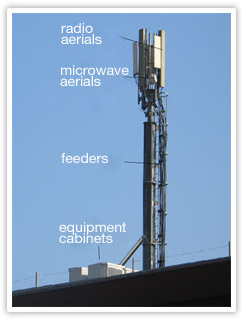

A base station is made up of several distinct parts. The most visible parts are the aerials. They achieve the transformation of the electrical signal into electromagnetic waves and the other way around. There are two types of aerials in a base station: radio aerials, which ensure the connection with mobiles, and microwave aerials, which connect with the network. Radio aerials are shaped like small panels, and microwave aerials usually look like cylinders.
components of a base station
A frequent misconception is that aerials emit in all directions, in the way a light bulb emits light. In reality, they are directional, in other words the power received is radiated like a beam, similar to the light beam from a headlight. This beam is almost flat vertically and has an opening of between 65 and 90 degrees horizontally. These aerials are the main generators of electromagnetic fields in the base station.
The microwave aerials emit a narrow beam of a few degrees, both vertically and horizontally, as they connect two fixed points. This is why the field generated by them outside of this beam is regarded as negligible.
Aerials are connected by means of cables to a metal cabinet which houses the electronic equipment used for control and transmission, power, cooling etc. Although less visible, this equipment represents the actual base station.
