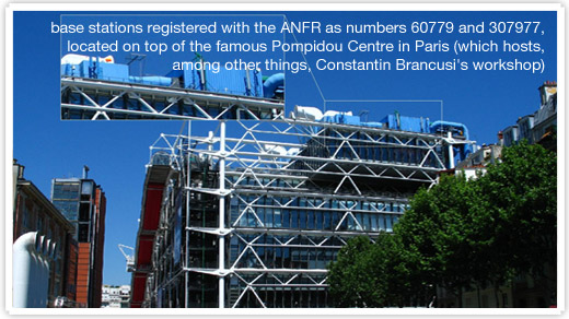

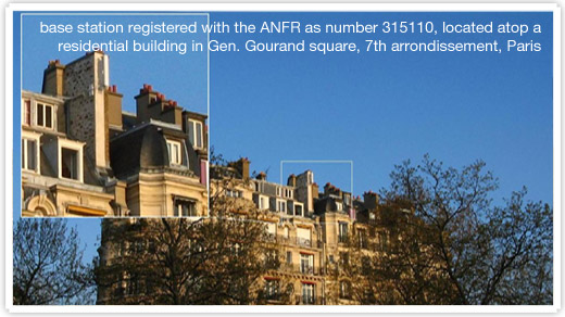

As is the case in most European Union states, the regulations comprised in European Council Recommendation 519/1999 are in force (they’ve also been adopted by Romanian legislation). Contrary to opinions expressed in various media channels, in France there are no restrictions to building base stations inside cities. If these base stations hadn’t been placed inside cities, it wouldn’t be possible to communicate using mobiles. You can see the location of these stations and other radio transmitters on the website www.cartoradio.fr belonging to the National Agency of Frequencies (ANFR). There you’ll also find measurement reports carried out by the agency at various locations.

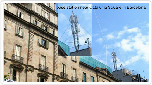

The limits set by Recommendation 519/1999 were also fully adopted in Spain, Portugal and The Netherlands. In the latter country, the Health Council (Gezondheidsraad) set up an expert commission for the purpose of investigating the scientific knowledge in the field and to generate reports and recommendations on this topic. They can be downloaded from the institution’s site: http://www.gr.nl
